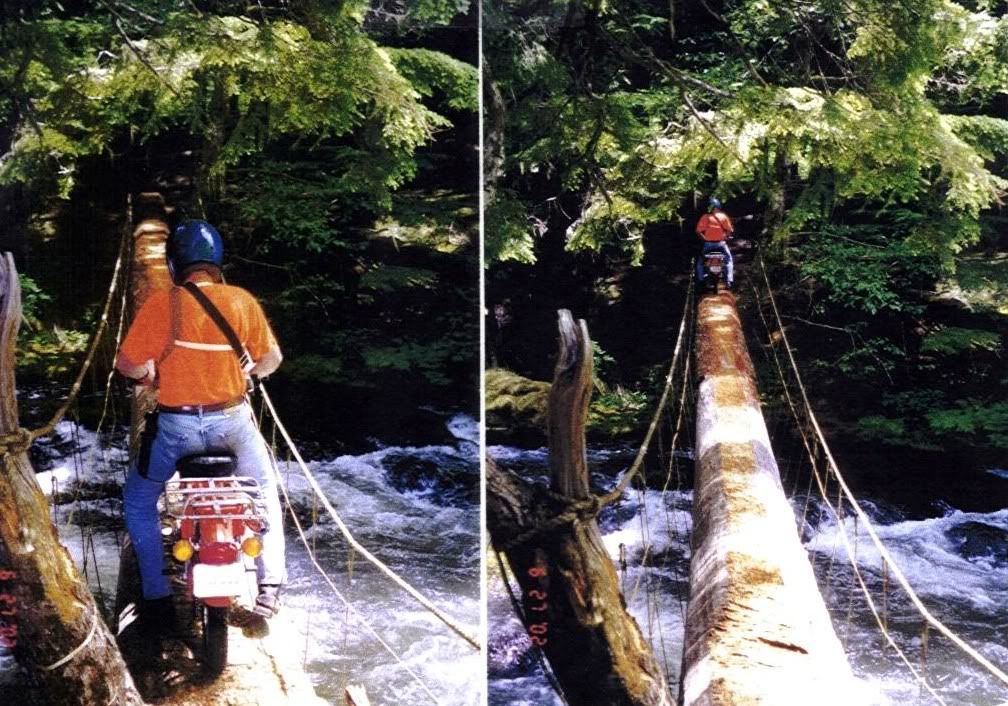

is that picture in your below your name you? i don't know if i would have the courage to ride across a log.

Here's the full size pic [img][/img]
The forest service tore down the only bridge to my favorite road system.
We found this fresh fall, took a saw and made a flat cut down the length of it. Then made a checkerboard of cuts for traction. after about a year the fs found it and cut it in half. So now we have some heavy commercial fishing rope and a pulley and scoot the light bikes over the creek that way. In september the creek gets low enough to just ride across. In the spring it can be over eight feet deep :(
My trail 90 was perfect for crossing. No way I'd risk a bigger bike then that.
I also had a dozen or so friends in case things got ugly.
View user profile http://www.facebook.com/venture72

that looks awesome and white knuckling at the same time...great pic. (i still think i would want a wider log LOL)

Very inventive using a fallen log and making a bridge out of it like you did. For me, I would have to be pretty desperate just to walk across it let alone ride. I'd be the one waiting until September to drive through the creek!

Good grief, you are one adventurous fellow. My barber is a motorcycle guy and I bumped into him at the hardware store one day. He had cables,pulleys, I hooks and such. When I asked what was going on, Hayden took me he/they were makeing a pulley system to get their bikes across a creek to they could ride the other side. Boy oh boy, some folks are pretty hard core. Gerry
