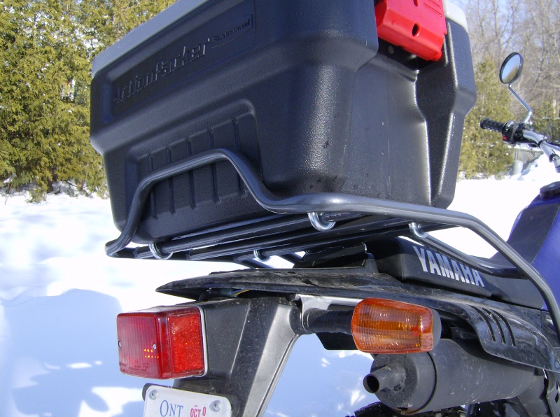

Hows that box been working for you? I have been trying to figure out what I want to do for a trunk. I will need it for my commute next year.
How did you attach it? U-bolts from the hardware store? Are the latches staying closed, or do you pin them?

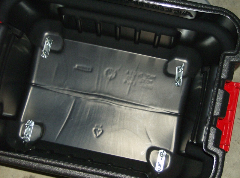

The box works great. I just used ubolts with wingnuts for easy removal. here are some pics.
my tdub Bike_t12
[img]my tdub Bike_t13[/img]

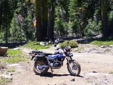

This should be a picture of my rig. Boy, guess it is an old one. I have since replaced the stock tank with an XT600 and the white PVC tube on the rear holding two 22oz MSR fuel bottles has now been replaced by a one gallon Tour Tank. Gerry
my tdub TwonPhilbrooktrail
Thank you so much. We are twins now ;)
I stopped by the hardware store and wally world this evening. It is all bolted up. I had to relocate the coupler for the dune flag forward, but that was easy.
I added some foam adhesive to the lid to seal it.
Thanks for the pictures and inspiration.
