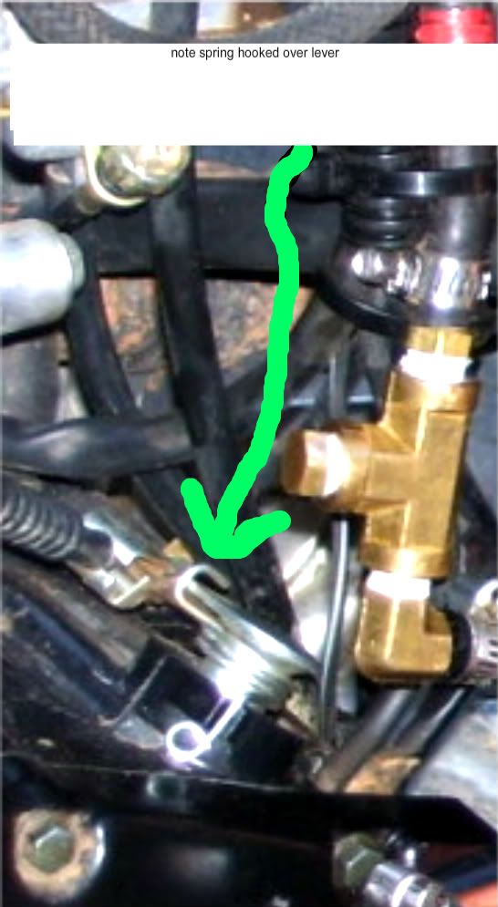

Make sure the 'return' spring is hooked up and onto the clutch-arm comming out of the left side of the engine case. Many of us have had the spring left unconnected to that lever. This make the clutch action very soft. Gerry

Anyone have any photo's of a properly placed return spring?.

[img:98e4]http://tw200.forumotion.com/[/img]
Saw your post on Adv. rider, hope you got things straightened out. here is another shot. More than a few of us did not have the spring hooked up and over the arm. Here is another great place to get TW information, http://tw200forum.com/ Gerry

PostSubject: Re: clutch problem?   Mon Jun 13, 2011 2:55 pm
Thanks a bunch gizmo!!!...also received a reply on Trailway forum...i bounce questions off of several forums cheers
When I got home from work last night,did some looking and BINGO,return spring was not hooked up correctly!!!.Hope this clears-up the shifting on my bike----2009 with less than a hundred miles on the clock.

PostSubject: Re: clutch problem?   Mon Jun 13, 2011 2:58 pm
Also gizmo,what the heck is that brass lookin contraption on your photo???.

PostSubject: Re: clutch problem?   Wed Jun 15, 2011 12:38 pm
Bike shifts much better now the spring is in it's proper setting!.
