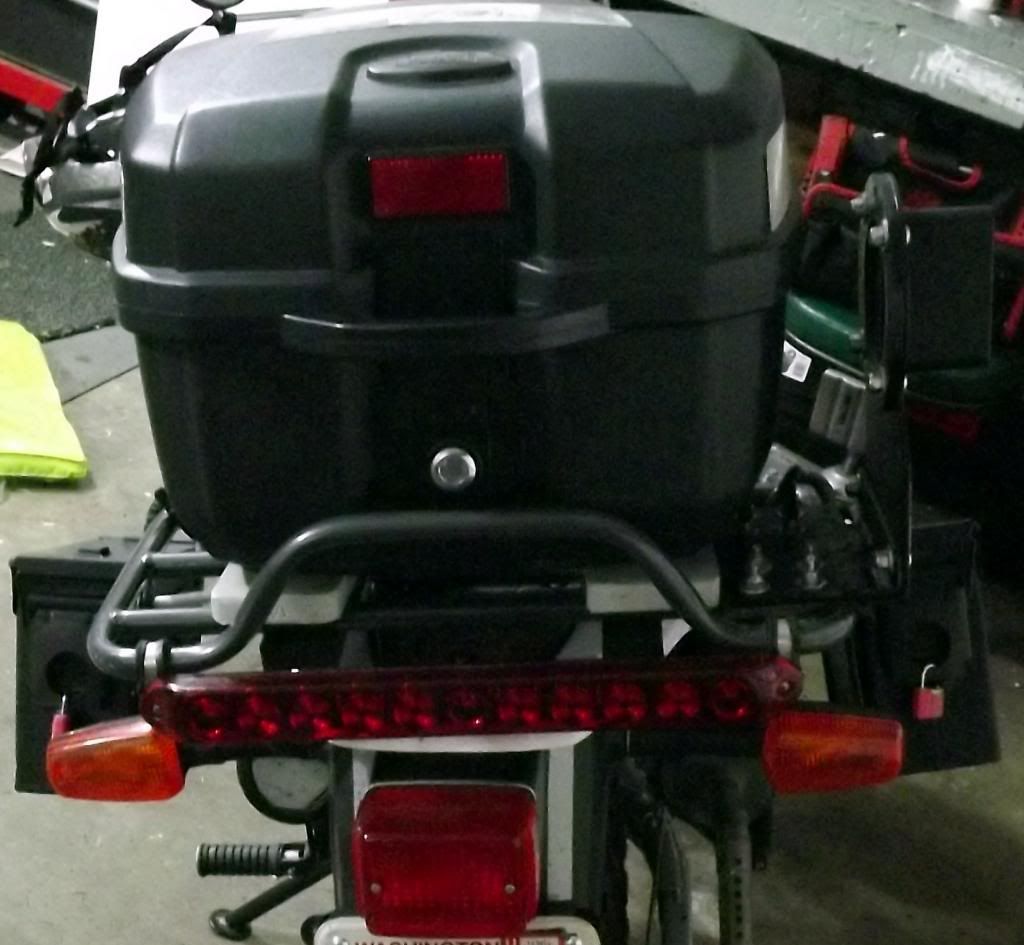

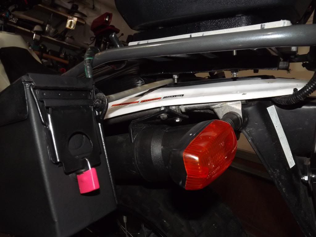

First i cut off the stock cargo straps
I took a 2' hunk of 1/4" stainless threaded rod and slid it through some plastic tubing
Added a couple of washers and nylock nuts
Prepped and sprayed the ammo boxes with spray on bedliner.
here are the results... The thing is rock solid

I like the pink lock. Giggle!

It should keep the honest people out. innocent
It's a bronze colored lock that I cushioned with red electrical shrink wrap.
